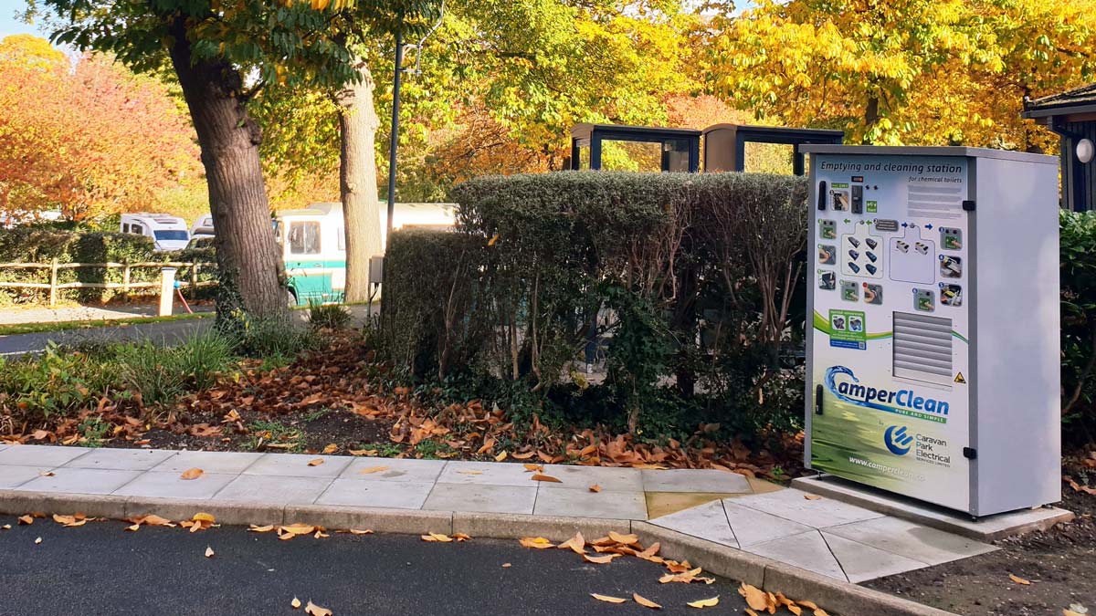

Camper Clean
When visiting our Abbey Wood, Brighton and Coniston Park Coppice Club Sites you’ll have the option to use our CamperClean facility. For only £2 per use, simply insert your cassette and CamperClean will not only empty but also sanitise in around 3 minutes. This can take away the hassle of manually cleaning the cassette using traditional blue cleaning fluids. For more information on how to use the CamperClean, you can either watch this video or speak to our Site Staff.
