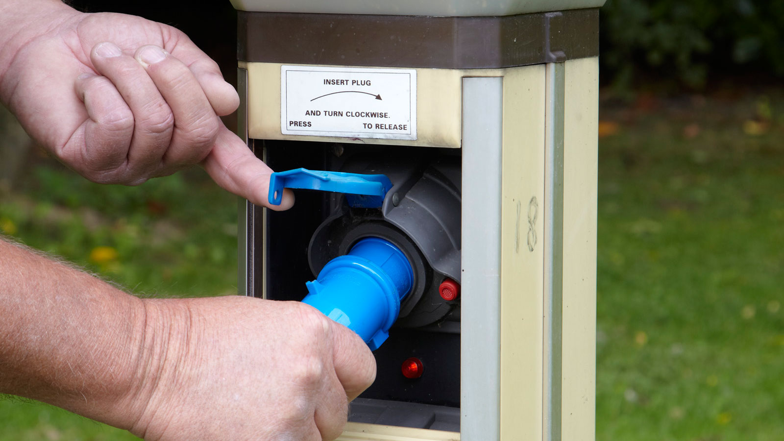

All Caravan and Motorhome campsites, where mains is available, have socket outlets which comply with this standard. Most of those on Club sites have a ‘plug in and turn clockwise’ action. On Certificated Locations and other sites the plug may simply push straight in.

Using the hook up point on site
The maximum permitted distance between socket outlet and any point on the caravan pitch is 20 metres. The use of cable joiners and or splitters is not permitted on Club sites and we highly recommend the hook up lead should be 25 metres (+/- 2 metres) of flexible cable supplied by the caravan manufacturer, this will enable you to connect your outfit to the electric hook up provided.
