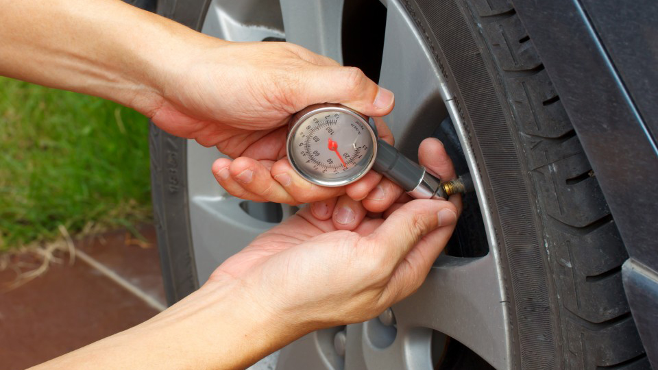

Tyres
  • Check inflation pressure regularly
  • Examine tyre treads and remove stones regularly
  • Remove any oil, fuel or paint
  • Check the tread wear regularly – the legal minimum is 1.6mm across the central three quarters of the tread breadth around the entire circumference of the tyre. Major tread wear during the normal life of the tyre may indicate a more serious problem, such as incorrect loading, wrong inflation pressure or even poor wheel alignment. Tyres which are operated in an overloaded condition may also show uneven wear across the width of the tread. Even a small variation in wear across the width (as little as 1mm according to tyre industry sources) is a possible indication of overloading.
  • Replace any tyre that has blistered, ruptured or been cut penetrated by an object. Developing problems can sometimes be detected most easily by running a gloved hand over the surface to the tyre, feeling for any raised or uneven areas.
  • Establish a routine to check tyre condition each time you check pressures. Do not forget the side of the tyre facing away from you, although to check this surface thoroughly, you will periodically need to remove the wheels from the vehicle.
  • If you’re not going to use your caravan for a lengthy period of time, we recommend that your remove the wheels and tyres and store them at normal inflations pressure in a cool, dry place and protect them from direct sunlight, sources of heat and fuel/oil spillages. Cover with a natural material, not plastic, for protection. Note that the terms and conditions of your caravan insurance and/or storage site might prevent you from removing the wheels during storage. This may either be to facilitate the use of security devices, or conversely to ensure the caravan remains moveable to provide access within the storage area. If wheels must be left on, rotate them regularly, so that the caravan’s weight does not rest on one area of the tyre all the time
  • Check the condition of your tyre valves. Make sure the valve stem is undamaged, and is correctly aligned with the valve aperture in the wheel, and not distorted when the wheel trim (if fitted) is installed. Be sure that all valves have suitable valve caps. Valve caps that have sealing washers offer better protection against dirt and dust. Check the valve is not leaking especially after measuring the inflation pressure. Make sure the valve has closed again correctly - if in doubt, fit a new valve.
