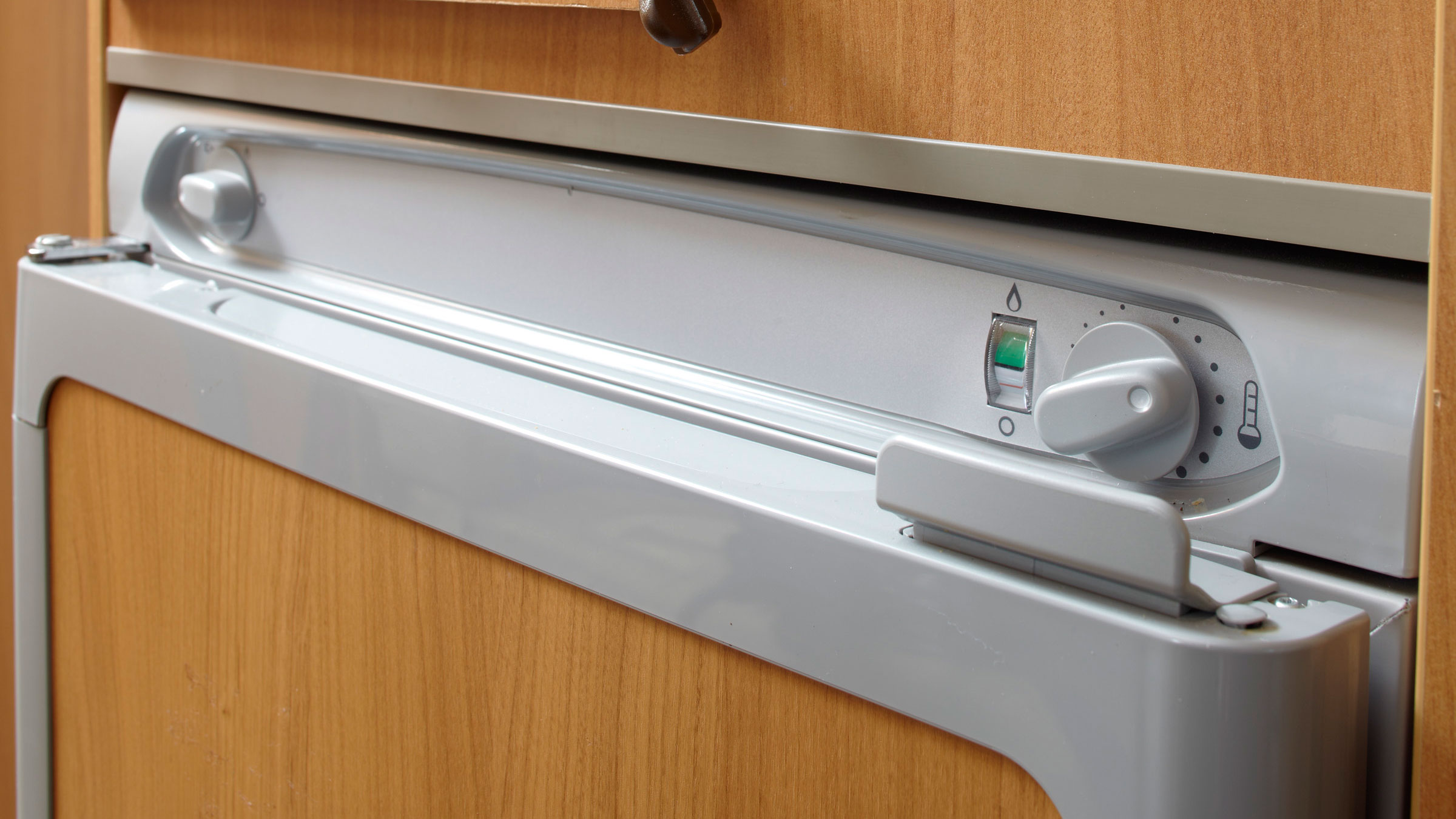

Most modern caravan refrigerators are absorption fridges with no moving parts. They use one of three power sources - a gas flame, a mains electric element or a 12-volt element from the car’s electrical system when the engine is running. The latest models have an automatic setting, which selects the most appropriate energy source.
Before using your refrigerator, read the operating instructions thoroughly and adjust the thermostat according to the weather conditions.
