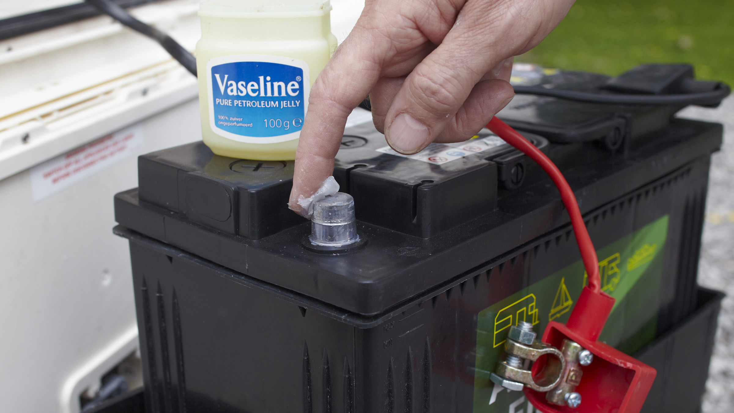

Maintaining and charging older batteries
At least annually, thoroughly clean the battery tray, terminals and connectors and smear the latter with petroleum jelly. Unless 'sealed for life', remove the battery vent plugs or strips and shine a torch into each cell to check the electrolyte level, which should cover the plates completely. If the plates are exposed, top up with distilled and de-ionised water; never use tap water or meltwater from a 'fridge. Check with the battery manufacturer's literature regarding how much water to add.
